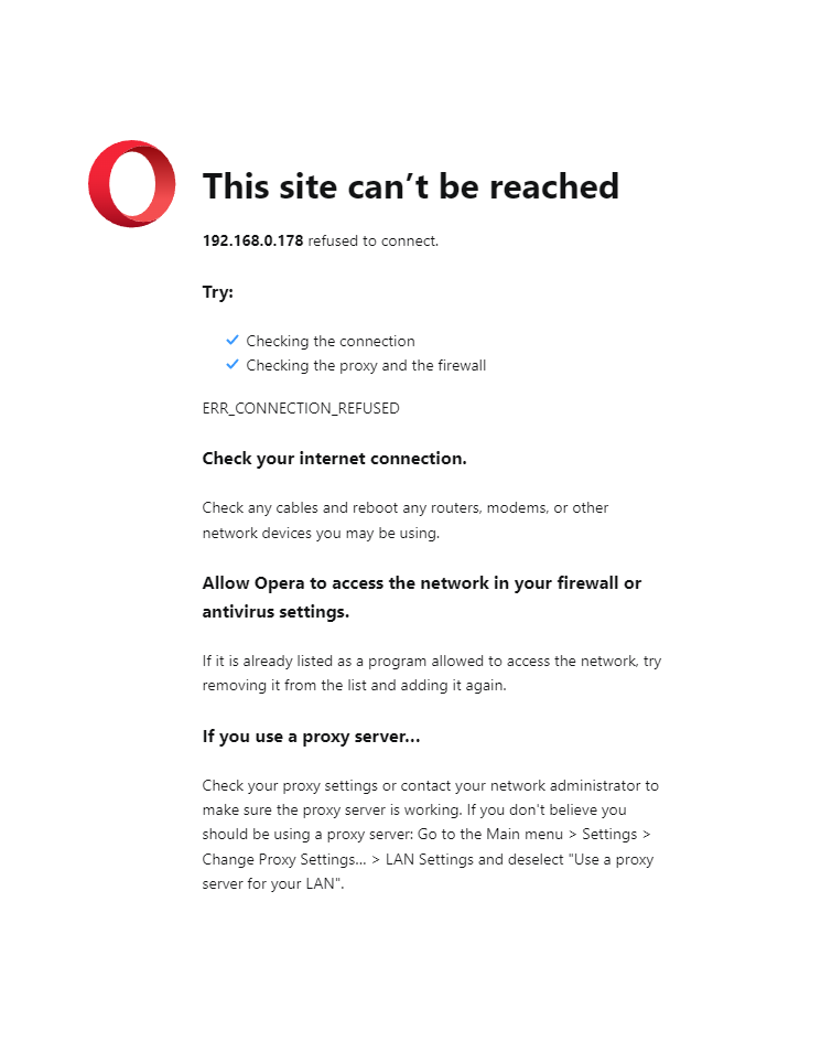

If this is the ip of your server, put this into the address bar
http://[server ip address]:32400/identity
http://192.168.0.178:32400/identity
You should get an XML file with a readout that looks like this
<MediaContainer size="0" claimed="1"
See if it says claimed 1 or claimed 0
If it says claimed 0 you need to reclaim the server. ChuckPa has a tool to help do that

Well, I got this response anyway:
