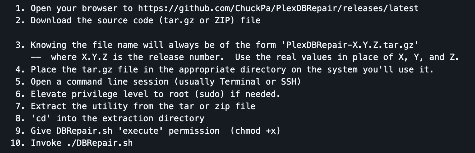

You will need to repair your database too: GitHub - ChuckPa/PlexDBRepair: Database repair utility for Plex Media Server databases
Yeah unfortunately this is where my knowledge falls apart entirely.
To run through the list in the screenshot, I can get as far as step 5, opening Terminal, before I have no idea what any of it means. I understand extracting a file in as much as running Archive Utility to extract something, past that my knowledge base is zero I’m afraid.

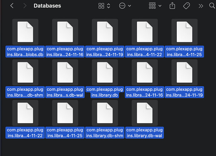

You can delete those files, its just not my first choice. What you can do as a test, is stop plex, rename the blobs.db and library.db files by adding .old to the file names (keeps the files as a fail safe, but moves them out of the way) Then take the 2 files ending in 24-11-16 and rename them to end with .db instead of the date. Then restart plex. That will revert your database back to the oldest backup you have which is hopefully prior to the crash.

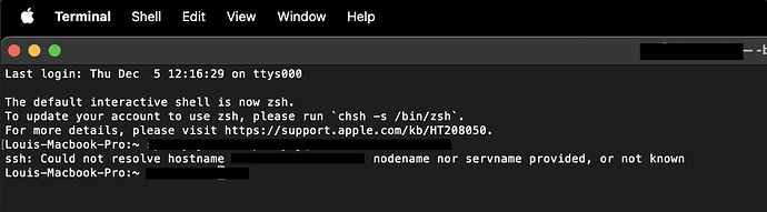

In Terminal when I enter ssh (myusername)@the IP address of the server it returns this:
I assume I’ve fallen at the first hurdle, whenever I’ve tried to make anything work in Terminal it has never worked, so yeah, apologies, I am not too literate at this side of things.
