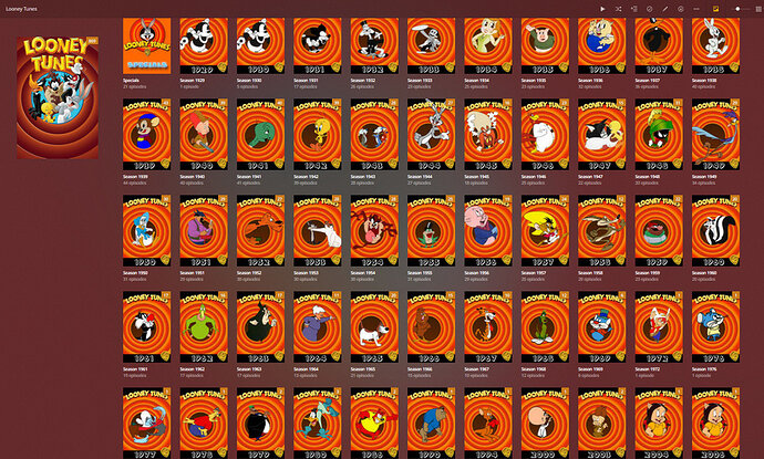

I took the pain route and did 543 episodes as a TV series…and am thoroughly enjoying them!

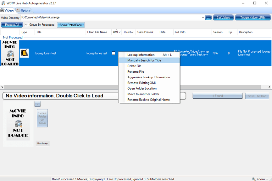

I actually used thetvdb.com to determine the year/episode # for a given title, and then used an old program called wdtvhubgen (which I mentioned in this post) to name the file.
Wdtvhubgen is a program I used to name files and gather metadata for my wdtv boxes years ago. Still use it religiously for naming movie and TV show files. The movie poster art is low res though, so I have to select a higher res version from the Plex edit screen, or elsewhere.
Opening the file in wdtvhubgen select the Manually Search for Title menu option.

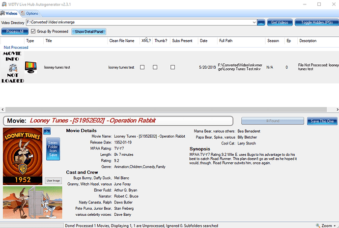

I know going into this that the Looney Tunes video title is Operation: Rabbit. A little searching on thetvdb.com reveals this is season 1952, episode 2 so I enter those values in the manual search box.
Choose Looney Tunes from the search results…

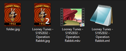

The episode metadata is then displayed, and you have the option to save, or start over. Saving renames the file, creates an xml metadata file (not much use with Plex) and an episode poster.
Here are the files created along with the renamed video.

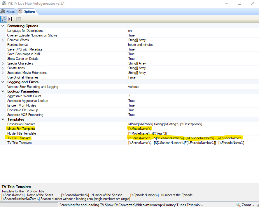

Worth noting are the strings for naming files under the Options tab, which I did tweak from the settings the program originally came with.
Not the most elegant solution, but it gets the job done…and it’s free.
