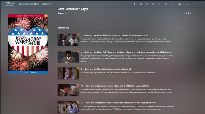

And inside plex it looks like this:
I am used to the multiple episodes showing up like this…but my question is this…is there a way or can it be a feature in an update to allow these to actually be MERGED inside of Plex? So that ONE file = ONE episode. So that it will be labeled as Episode 1-3. And the next one, in this case, would be named Episode 4-6.
This would be a huge benefit to server owners and viewers as you would not have to SKIP episodes when watching. Not the end of the world but a pain to have to skip episodes to get to the next NEW one. And if you don’t know the series you actually have to start watching each to notice you have already seen it.
Anyway, just a thought / question. This would really be a nice feature to add if there isn’t already some way to do it.

I did use the delete to my advantage. I couldn’t figure another way to get PLEX to NOT show the episodes that had no business being there so I used file delete via Plex to make them go away. I fixed the first episode in each sequence to have the correct information and then deleted the rest. Then before Plex could rescan I un-deleted the file in the system. Yes, a pain but it accomplished (sort of) what I was looking for. Here is what the result looks like:
And my files names are still correct:
Love, American Style [Comedy] - S01E01-E03 - [1969-09-29] (480p, MP3@2ch) - Love and a Couple of Couples & Love and the Hustler & Love and the Pill.avi
Love, American Style [Comedy] - S01E04-E07 - [1969-10-06] (480p, MP3@2ch) - Love and the Living Doll & Love and the Letter & Love and the Joker & Love and the Unlikely Couple.avi
Love, American Style [Comedy] - S01E08-E09 - [1969-10-13] (480p, MP3@2ch) - Love and the Phone Booth & Love and the Doorknob.avi
Now, here is hoping when Plex does a full rescan of everything it won’t change it all back. LOL
Greg

Renaming them to
Love, American Style [Comedy] - S01E01 - [1969-09-29] (480p, MP3@2ch) - Love and a Couple of Couples & Love and the Hustler & Love and the Pill.avi
Love, American Style [Comedy] - S01E04 - [1969-10-06] (480p, MP3@2ch) - Love and the Living Doll & Love and the Letter & Love and the Joker & Love and the Unlikely Couple.avi
Love, American Style [Comedy] - S01E08 - [1969-10-13] (480p, MP3@2ch) - Love and the Phone Booth & Love and the Doorknob.avi
Followed by
  • scan library files
  • empty library trash
would’ve achieved the same. Without having to delete and un-delete.
