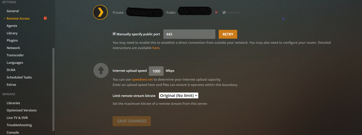

THanks. I’ll check these out. But I don’t see this section (internet Upload Speed) on my Remote Access page.
FYI, according to the Remote Access docs, Internet upload speed and Limit remote stream bitrate require a Plex Pass.
