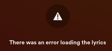

I have plex pass, and lyrics are enabled, but dear goodness I can not for the life of me get lyrics to work. I’ve followed every guide that I could find and nothing works.

It doesn’t show on the web, Plex or Plexamp.

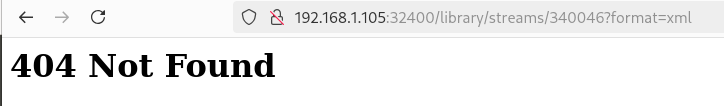

The issue is on the server side as it appears for all client (Plexamp, web, android). The server logs show a 404
Jun 05, 2025 19:09:52.165 [140258114677560] DEBUG - Completed: [192.168.1.4:33746] 404 GET /library/streams/340046?format=xml (14 live) #39841 TLS GZIP 449m
s 507 bytes (pipelined: 8)
Trying to got to the URL does return a 404 : http://192.168.1.105:32400/library/streams/340046?format=xml
The track XML does show the correct stream ID :
<Stream id="340046" key="/library/streams/340046" streamType="4" codec="lrc" format="lrc" minLines="3" provider="com.plexapp.agents.lyricfind" timed="1" displayTitle="LRC" extendedDisplayTitle="LRC (External)"> </Stream>
What more do you need to be able to debug ?

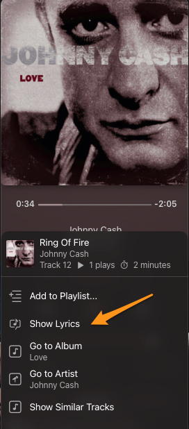

Make sure. Find Lyrics is enabled for your music library.
In Plexamp it is here
You can message them to me by clicking on my username/avatar
That option is not showing up, and they are enabled in the settings.

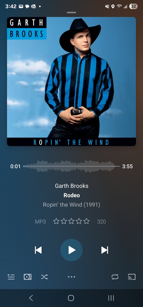

I am in the US and here are my settings. Still no lyrics option in the apps. I’ve tried PC, phone, tablet etc.
What do you suggest I do? Delete and refund the sources?
