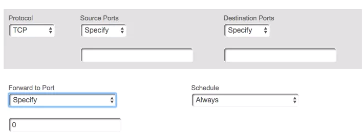

@shark2k sadly I’m stuck using the Verizon Fios supplied modem router combo “Fios Quantum Gateway G1100” to avoid a Double NAT situation.
I have the local IP address of my server set as static through my router and, as you describe above, I input the forwarded port in “manually specify port forwarding” of server setting, check the box, and then repeatedly, hit “apply.” Each time, I get the red X.
I mean no offense by this, it’s just hard to establish clarity on both ends of text conversations. But, just to be clear, you are entering 2 ports into your port forwarding rule right? The external port that you choose, and the internal or “forwarded to” port that has to be 32400.
IIRC, on fios gateways there is an “Advanced” button you have to click to get the second internal/destination port entry. The default is same as the forwarded port, this must be changed to 32400.
@tobytl no offence taken. I’m a novice here trying to wrap my head around this. I did not realize about the additional layer of setting in the fios gateway. Now I see… Below is a screenshot of the advanced setting with all the options set to “specify.” Can you lend any direction on how what does where to forward an external port other then 32400:

Wow, that is a confusing layout for port forwarding. But if it follows standard terminology:
  • Source Ports: Should be set to “Any”. It’s probably in that drop down list.
  • Destination Ports: This should be the port you choose (the one between 20000-50000 to be safe)
  • Forward to Port: This should be 32400.
After that, ensure you enter the port you put in “Destination Ports” into the remote access settings in your plex server and Apply.

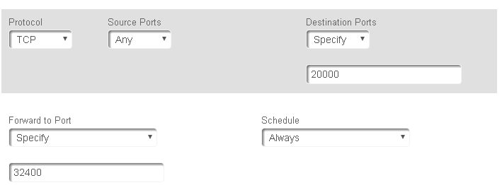

@hf995 I was going to reply with the setup, but @tobytl beat me to it.
I’m attaching a picture to show what it should be (this is from my router, I just put an arbitrary port in the Destination one for the example.
-Shark2k
@shark2k @tobytl thank you both for you help! The effort is very much appreciated.
