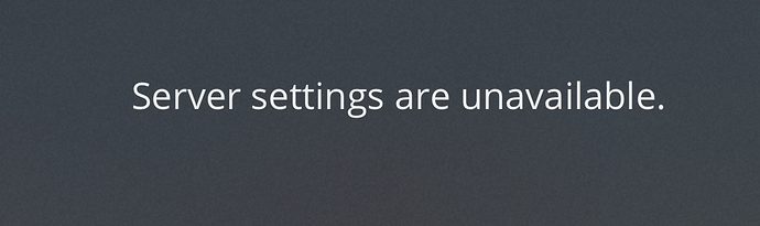

I would like to run PMS from my NAS. I have deleted the PMS on my mac and when I try to log in through my local ip through Nas onto plex via the app on the NAS, I am facing the following error.
I’m confused by this. What did you do? You should be using your Mac and browsing to “https://IP_OF_NAS:32400”.

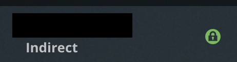

I have done the needful and the Media Server has been detected from the NAS directly. Thank you.
I am facing issues with direct connection which I havent faced till now. attached are the screen shots. How do i connect directly.
Check this. https://support.plex.tv/hc/en-us/articles/200931138-Troubleshooting-Remote-Access

I have done Step 1 & 2.
Step 3) My server is remote and upon trying to get a direct connection, it says indirect connection available.
