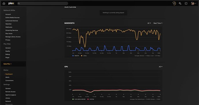

Hi there! I am hoping for some support re: my PMS crashing when attempting to download movies onto my iPad. For what it is worth, I have done this countless times without any issues whatsoever and even downloaded several movies last month for a business trip. This time around my server is just freezing up on me.
In the screenshots below you’ll see CPU resources aren’t an issue. Looking at it from the console screen it just stops mid-download.
