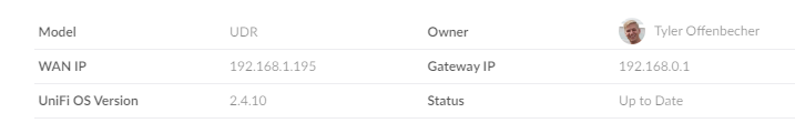

unfortunately i cant seem to find any option for bridge mode on the ISP modem. oddly, when plex was running on the Synology, i did not have this problem - which was only two days ago. here is what i get from the ubiquiti for wan ip.

You’re in a double-NAT situation. Your WAN IP on your UDR is 192.168.1.195; this is a private, RFC-1918 IP address, not routable on the public Internet. That 104.202.150.x IP address is the WAN IP address of your ISP modem/router.
Try logging into your ISP modem/router and creating a port-forwarding rule that forwards TCP 40425 to TCP 40525, IP 192.168.1.195. Post a screenshot of this newly-created rule if you continue to have issues.
