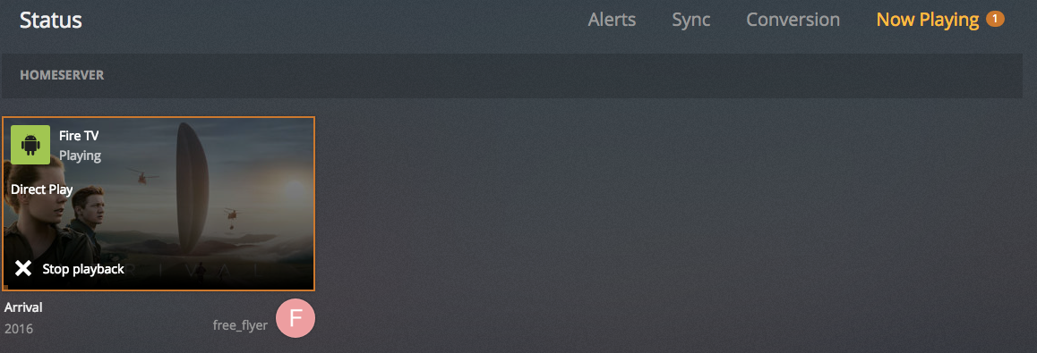

Plex shows that media is encoded with 5.1 audio and the Plex playback settings show that it is playing 5.1 audio…

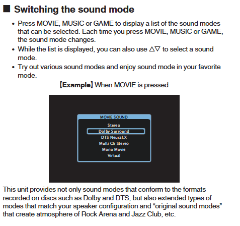

I fixed the problem by changing the sound mode on the Denon AVR to Dolby Surround…

@free_flyer There is a bug in the Plex client for AFTV devices. Right now AFTVs only put out stereo audio. This is supposed to be fixed in version 6.13.x, which has been submitted to the Amazon app store for approval. Only caveat is that the fix does not work for AFTV gen 2 boxes due to a firmware issue on the device. All this is mentioned in other threads - look in the Android TV area of the forum.
So, wait for the v6.13 update and you should get 5.1 sound back (unless you have the gen 2 box).
