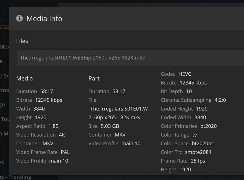

Can you post the Plex info XML for the video? Trying to see if anything would cause what you are seeing, since neither Plex or the shield interpolates frames that would cause the soap opera effect from a 25p source video.
I don’t see anything weird with it. Not sure what to tell you. If you turn off refresh rate switching and set your shield to 25Hz, how does it look?
