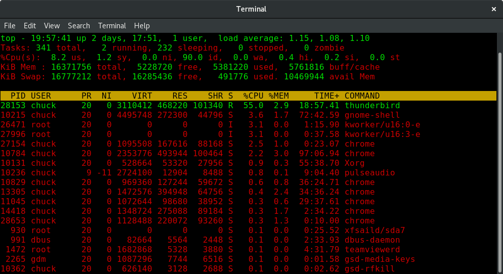

Ok… Now we’re going to use regular top (not htop)
What we need to look at is the RES (resident) value.
Except for color, you should see this:

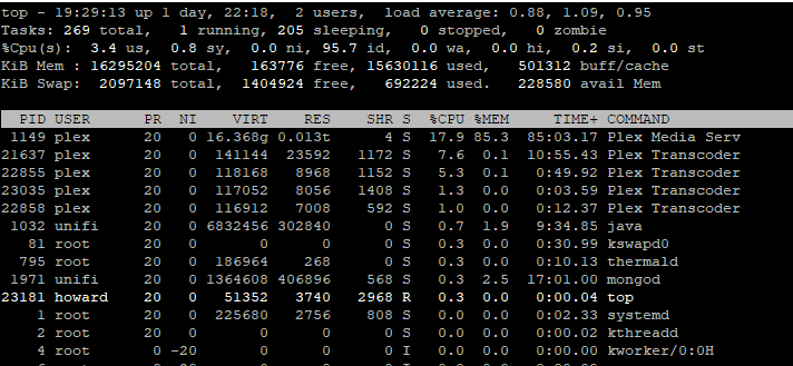

What is the VIRT and RES size for Plex’s processes ?
130GB is a lot! that’s a leak. Let’s force it down
