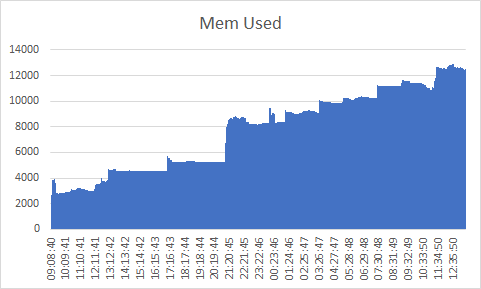

This wasn’t a spike per se. It was a steady build up from
Fri Apr 26 09:08:40 CDT 2019
              total        used        free      shared  buff/cache   available
Mem:          15913        2648       11884         255        1380       12738
Swap:          2047           0        2047
to
Sat Apr 27 11:58:50 CDT 2019
Mem:          15913       12595         277         237        3039        2751
Swap:          2047           0        2047
Sat Apr 27 11:59:50 CDT 2019
Mem:          15913       12561        1172         237        2178        2785
Swap:          2047           0        2047
This is where it’s just about reached the end of the buffers it can dump.
The last line in the file:
Sat Apr 27 13:26:50 CDT 2019
Mem:          15913       12511         542         237        2858        2835
Swap:          2047           0        2047
Shows it’s close to swapping. When free gets back down to 160-ish again, it will swap.

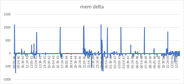

The diagnostics show the following memory increase pattern
Notable deltas
Date	    Time	    mem delta
26/04/2019	09:15:40	+1108
26/04/2019	09:25:40	 -741
26/04/2019	13:02:42	 +826
26/04/2019	17:02:43	+1012
26/04/2019	21:02:45	+1011
26/04/2019	21:05:45	+1065
26/04/2019	22:22:45	 -514
27/04/2019	00:01:46	+1106
27/04/2019	00:07:46	 -510
27/04/2019	00:10:46	 -635
27/04/2019	00:11:46	 +526
27/04/2019	00:21:46	 -676
27/04/2019	01:05:46	 +986
27/04/2019	03:25:47	+1012
27/04/2019	07:25:48	 +997
27/04/2019	11:25:50	 +839

This shows the major memory usage changes over 36 hour period
and last set of changes - 2 big changes we do not have logs for

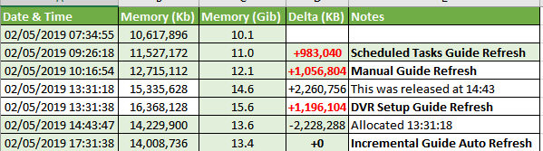

So server was launched just before May 01, 2019 16:53:32 with 10-second memory snapshots for the Plex Media Server process from 16:55:33 up to May 2nd 18:49:17
During the snapshots period memory use for the process went up from 3,654,564 Kb (about 3.4Gb) to 14,049,716 Kb (about 13.3 Gb)
We have logs covering period May 2nd 07:34:54 am to 18:46:31. During the period of time covered by the logs, the memory snapshots shows increase from 10,617,896 Kb (about 10.1 Gb) to 14,049,716 Kb (about 13.3 Gb) - about 3Gb increase
DVR Guide refreshes happen by default every 4 hours plus one refresh for scheduled tasks. The 4-hour refresh is adjusted after the scheduled task is run - so the pattern would be every 4 hours until scheduled task runs and then every 4 hours from that time.

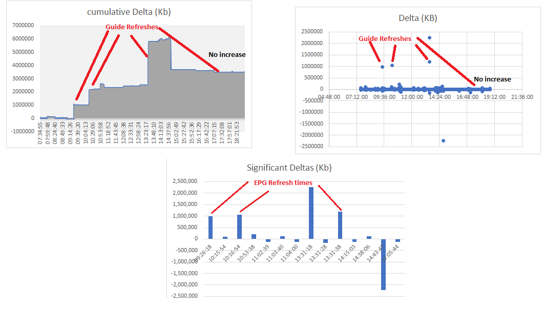

The period covered by the logs show 4 Guide Refreshes taking place and memory usage increased with 3 out of these 4 refreshes. So Guide Refresh activity is still suspect - but we would need to understand why one of the refreshes did not. There was a manual guide refresh and also a DVR setup which would recreate the guide - so we do not have just the 4-hourly incremental updates to the guide here
These charts show the increases - and as mentioned 3 of the increases correspond to DVR Guide and channel setup activities
This shows the times and what is implicated
The issue with suspected memory leaks relating to DVR Guide activities is already known and being looked into. The only anomaly we have here was the 17:31 Guide incremental refresh which did not appear to increase memory
Whilst the issue remains unresolved and under investigation by the development team, please schedule restarts of the server every 24-48 hours
For the periods before the time covered by the logs, there were 3 memory increases that clearly relate to the Guide refreshes. They appear at 4-hour intervals which must have been for the guide auto incremental refreshes
