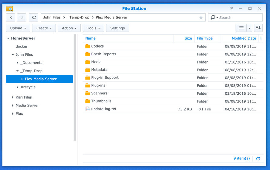

OK, I have the entire PMS folder inside of another share on the NAS (screenshot below). A few questions:
At this point, should i stop Plex from running on the NAS, and disable all of the auto-scan settings?
  1. We will then create the resultant directory structure Synology is looking for.
The restored directory is pulled straight from the old PMS install so it should be the same as the one that’s currently running on the NAS. Is there something else I need to do here?
  1. lastly, we’ll move it into position.
This is where I’ve run into problems in the past when trying to overwrite the existing Plex directory, or trash it to replace with the new one. Constant “file is in-use” errors and hiccups. What method do you recommend? Sorry if this is obvious and I’m just stupid!
  1. We’ll start moving the shares (EDIT folders), one at a time.
Similar question to above - so I should move the nested directories (“Metadata”, “Plug-In Support” etc.) one-by-one? If overwriting is a no-no, how am I replacing the existing directories that are in the current Plex share?
This is going to be a delicate procedure and, when the time comes, you will need to take certain steps as quickly as possible to preserve media (just in case)
The process will involve.
  1. Stop Plex
  2. Open another File Station window
  3. In that window, drill down into the Plex share, until you see “Plex Media Server”
  4. Rename it to “Plex Media Server.old”
  5. Now copy the “Plex Media Server” directory from “Johns Files” to this “Application Support” directory. (let it take all the time it needs)
  6. Right-click “Plex Media Server” → Properties.
  7. Change the ownership to user plex and "Apply to this folder, sub-folders, and files.
  8. Click the Permissions tab.
  9. Verify user plex is allow of R/W access. If not, change it and again Apply to this folder, sub-folders, and files
Now we are going to prepare to get into the Synology at the moment it becomes available so you can minimize metadata loss (worst case scenario)
  1. Open a new browser window
  2. In it, type http://ip.addr.of.syno:32400/web – DO NOT CLICK ENTER yet
  3. In Package Center - Start Plex
  4. The moment it starts, Go to that other browser window and click ENTER
  5. it may take a moment to respond so keep trying
  6. The moment you get into the synology, verify it’s actually looking at the Synology server (upper left corner)
  7. Cancel any scans running.
Now you can properly migrate again
  1. For each share which contains media:
    a. Control Panel - Shared Folders
    b. EDIT the share
    c. Permissions tab
    d. Make certain user plex has Read-only or Read/Write permission (so it can see your data)
  2. Now follow the process here of adding the new locations (where they are on the Synology) to complete the migration and retain metadata
