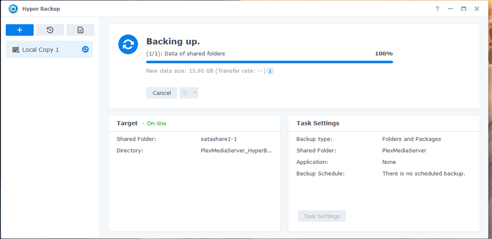

This is the first time I’ve used Hyperbackup.
Is it normal for this screen to be displayed for a long time, when the progress bar already shows 100%?
The size of the backup is very small, only 16GB.

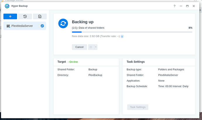

I’m running a backup now to confirm what you see.
I’ve not used HyperBackup in DSM 7.2.2 so want to be certain about what to expect.
Progress report. Here’s where it’s at.
It should complete within the next couple hours. (This is a little DS418j)

Mine finally finished.
Looking through the logs and watching it, I think they changed something about the verification, perhaps a second pass, after the main backup itself, is complete.
I was in front of the computer when the 1.X TB backup finished.
When the progress bar hit 100, the dialog box immediately showed that the copy completed.
On the 16GB backup, it took more than 30 minutes to show complete, after the progress bar hit 100%.
