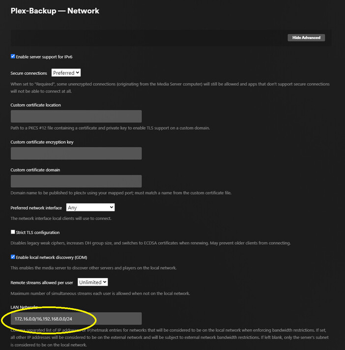

It was also an extreme struggle to make Plex Settings - “Remote Access” to be fully accessible outside your network (only an indirect connection worked).
After a very long search I found that I need to enter the following in Plex Settings - Network:
LAN Networks: 172.168.0.0/16,192.168.0.0/24
The first IP address is the subnet that kubernetes VMs lives on TrueNAS Scale (set in the TrueNAS Kubernetes advanced settings) and the 2nd subnet is subnet of my TrueNAS Server.
As a final check for the health of my Plex server, I also had a look at my log files if I could find any alarming errors or warnings and I did find some:
Apr 20, 2024 02:21:24.853 [140534868699960] ERROR - [Req#5a494] Error parsing allowedNetworks entry '192.168.0.024 ': Invalid argument [system:22]
Apr 20, 2024 02:21:24.856 [140534968810296] ERROR - Error parsing allowedNetworks entry '192.168.0.024 ': Invalid argument [system:22]
Apr 20, 2024 02:21:34.845 [140534968810296] ERROR - Error parsing allowedNetworks entry '192.168.0.024 ': Invalid argument [system:22]
Apr 20, 2024 02:21:34.848 [140534884866872] ERROR - [Req#5a4f9] Error parsing allowedNetworks entry '192.168.0.024 ': Invalid argument [system:22]
Apr 20, 2024 02:21:34.851 [140534970919736] ERROR - Error parsing allowedNetworks entry '192.168.0.024 ': Invalid argument [system:22]
Apr 20, 2024 02:21:44.849 [140534868699960] ERROR - [Req#5a542] Error parsing allowedNetworks entry '192.168.0.024 ': Invalid argument [system:22]
Apr 20, 2024 02:21:44.852 [140534970919736] ERROR - Error parsing allowedNetworks entry '192.168.0.024 ': Invalid argument [system:22]
I also found the reason for these errors. It is seems like something that could be improved in Plex. The problem was that there was a space after my list of LAN Networks. It would be nice if Plex could either not allow spaces or could properly ignore them…
After fixing that, I no longer see alarming errors or warnings in my log files
