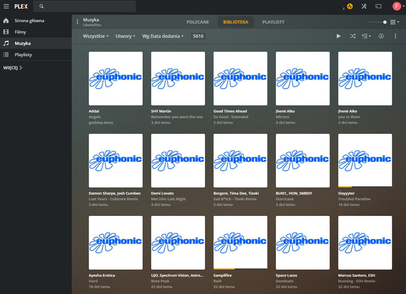

Thank you for your help and the information provided. I have it set to “prefer local metadata,” but album art was set to “plex only,” as this one makes the album art at least work for mp3s. Weirdly enough, if I switch to “local files only,” every single file in my library displays the same album art. So it looks like this
I guess I’ll wait for the fix as the program gets updated.
Thanks again!
That actually fixed everything We touched upon. Indeed, there was a couple of hidden jpg files in the folder. Once I deleted them, I could switch to “prefer local data,” and everything worked after rescanning. Both mp3 and FLAC files have their artworks visible.
