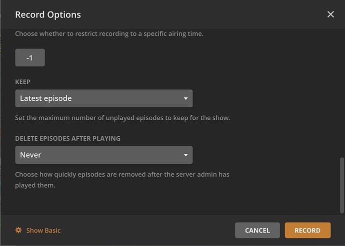

I setup Plex Live TV & DVR last week and there was a ‘Remove Commercials’ option under ‘Record Options’ to either: ‘Use DVR Setting’, ‘Disabled’ or ‘Enabled’ for a particular recording. Since that time I have updated the version of Plex Server to the version listed above, and had to remove and re-add the Tuner which basically means I had to reset up Plex Live TV & DVR. Since making those changes, I now no longer have the ‘Remove Commercials’ option under ‘Record Options’ for a particular recording. The ‘Remove Commercials’ option is still available under DVR Settings, just not under ‘Recording Options’.
In the end I want to be able to control per recording the ability to have commercials or not, versus just a global setting for all recordings.

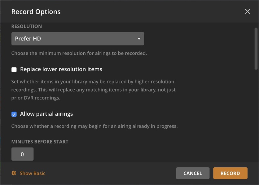

I’m on 1.16.6.1559 and am seeing that option both with the local web app (my Plex local IP:32400) and at app.plex.tv.
Just to see if it’s a server version issue, after clicking “Record” are you clicking on the “Show Advanced” link at the bottom left and scrolling down to the bottom of the Advanced Recording options? If so, can you post a screen snapshot?
Thank you! The remove commercial option is supposed to be where yours is apparently getting an error and showing a “-1” between the “Limit To Airing” time and the “Keep” number of episodes option. I haven’t seen this one and if it’s been addressed in the forums previously I can’t find it.

After that I tried to re-setup a recording and I still had the “-1” and no option for ‘Remove Commercials’.
I reviewed the console again and I see a number of “-1” notifications, but no errors. (see screenshot).
