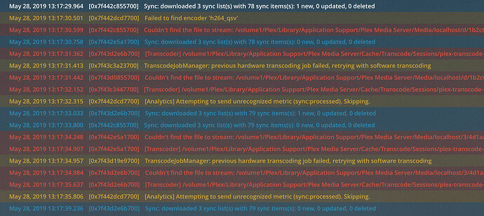

Here’s a screenshot of the Console when this happens. I can play the movie just fine, but it won’t convert for download on mobile, etc.
I’ll note that I moved from a non-hardware-transcoding NAS (DS1817+) to one that does, theoretically, have it (DS1019+). But obviously it’s failing both hardware and software transcoding.

Dave,
I found the problem. In this case, the SRT file is invalid (copied from Windows -> Linux?).

Specifically:
I would first check the permissions on the entire Plex share. I suspect the contents of the tmp_transcoding directory has junk which isn’t accessible OR the contents of the Caches directory under Library/Application Support/Plex Media Server.
In either case, the SRT is the problem. Hardware transcoding itself is working.
As verification, transcode / play something without subtitles.
