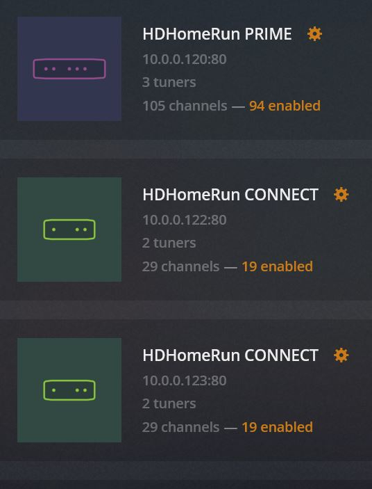

Based on that photo, it looks like QAM channels mapped to guide data from another channel line-up. Is that a screenshot of the prime or connect?
the ones with channels 2.1 2.2 etc… are the connects. Yes the OTA channels are mapped to my Comcast Lineup. Plex does not support multiple lineups but it supports diff tuners as long as the channels are mapped to the one lineup.

Do you have the same channels enabled on the Connects as the Primes? For me, the channels enabled between my prime and connect are completely different.
I disabled them on the Prime because they are only 1280x720P … you do not have to disable them since I have 4 connects in my household we disable them in the primes. Mapping took a while but you can map the OTA Broadcast channels to the Cable guide equivalent… Just make sure to setup the primes first.
