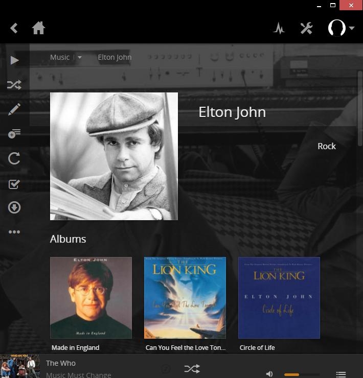

Again, not true. Plex uses the existing ID3 tags stored in the MP3 files to create its virtual tags at the artist and album levels. It shows those tags on the artist and album profiles. I have a basic music library. All of my Elton John songs are tagged as “Rock.” Here’s how it looks on the artist profile:
Sorry, not trying to be argumentative, but it seems like there’s a lot of confusion about ID3 tags: where they’re stored, how they’re maintained (e.g. not in Plex) and how Plex uses them (which it does). Here’s how Plex displays the virtual genre tags it created from the genre tags it read from my MP3s in edit mode on the artist profile:
