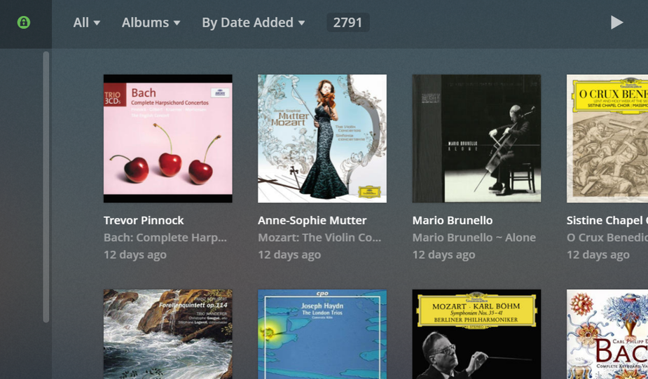

Music Library Scan runs forever, never finishing
Server Version#: Version 1.15.3.876
This is a premium library and I heard that they work worse than the normal ones. I would prefer not to have to recreate all my play lists when erasing and re-adding the music library.
Is there a way to see what the media scanner is crashing on? Which logs do you need from me?
This issue is new, the scan always finished before.
