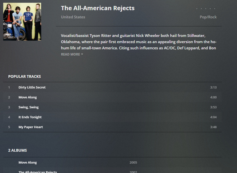

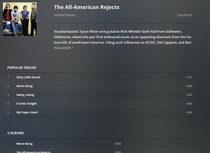

Hold on. So you are saying that when you shuffle your entire library, if an artist has popular tracks listed, you get those tracks from that artist first. Can you provide some screenshots? I can’t reproduce this. I have popular tracks enabled. This is a test library I use so very little has been played to impact the priority of the list.
My library.
First artist with popular tracks.

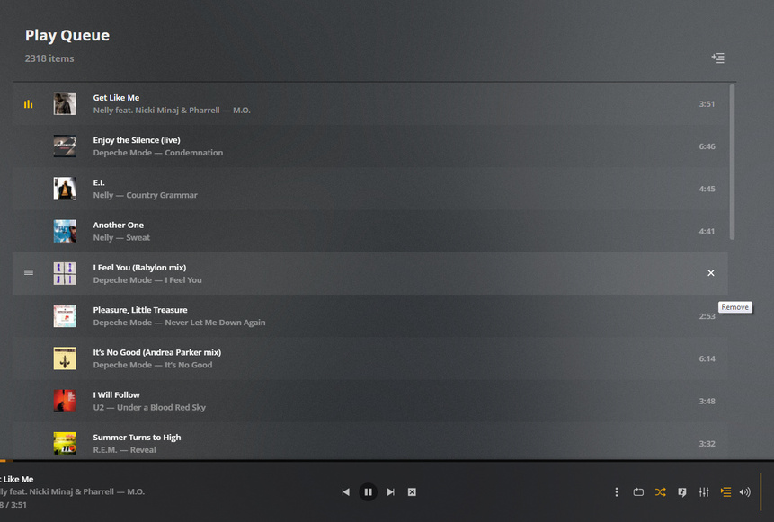

Hit shuffle from the library page then call up the play queue. That artist isn’t even in that first page.
Stop playback, hit shuffle again. I get a totally random list.

If I shuffle just 1 artist, then I do see that the popular tracks are being pushed to the top. I’ll need to check if that’s intended at the artist level.
Also, in my test, the first song that came up was Coldplay’s Midnight. Checking Coldplay, that song is not on the popular list either. So I can’t reproduce getting popular tracks to be higher than other songs at the library level.
