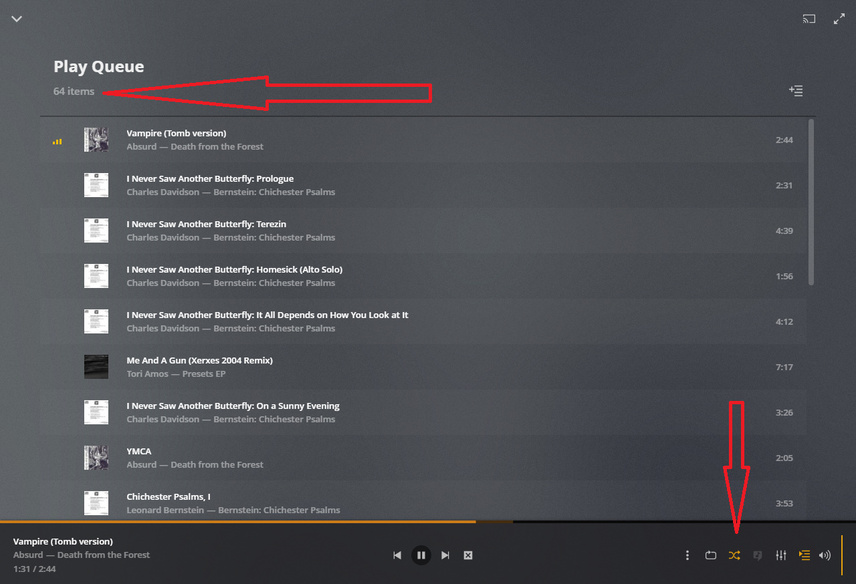

That’s not a playlist, that’s just a filter. Anyways, I’m not able to recreate the problem. It works fine for me. I created a list that resulted in 64 tracks, then hit shuffle. Checking the resulting play queue shows 64 tracks in the list.

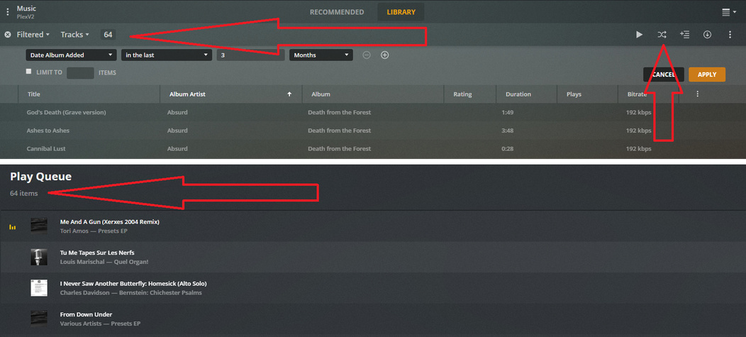

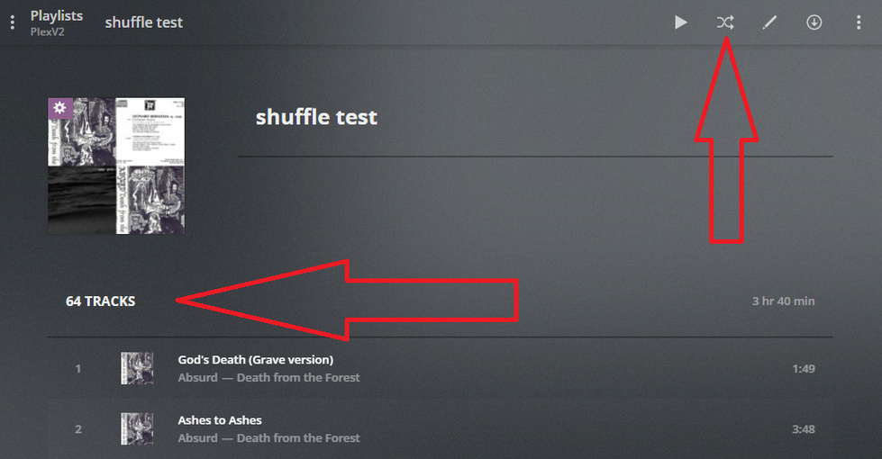

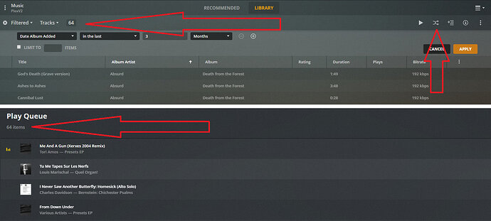

Still working for me. Here it is as a playlist.
Hit shuffle then call up the play queue.
Here is the filter for the playlist I created
I add it to a playlist, then hit go to the playlist and hit shuffle

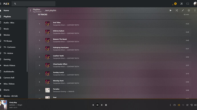

As you can see, it’s playing the theme song for the Pary Boy character from Jackass, which is not anywhere near being one of the 10 most recent tracks added, and is not a part of the playlist I created.
The playlist appears to be correct.
If I hit “play” it will play the songs in the playlist without issue.
It’s when i hit shuffle that it suddenly ignores the filter that created the playlist and shuffles my entire library.

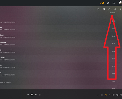

Hmm. Somethings not right from your screenshot. No way those 10 songs make up 82 minutes.

Does the queue also show 82 minutes? Those 10 songs don’t add up to 82, so something is wrong.
Yes, that is correct. It should be shuffling the same 10 songs just in a different order, at least until you add more media to change the result of your filter.
