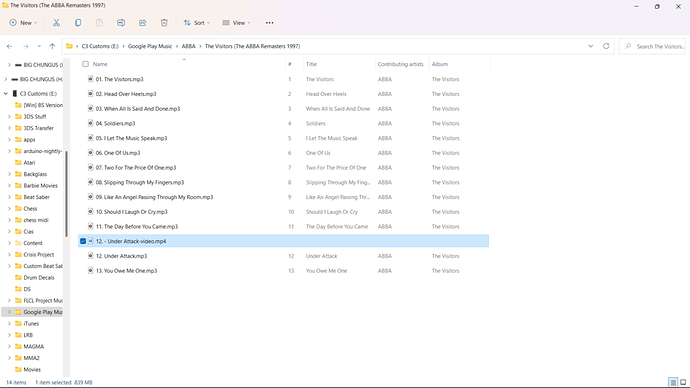

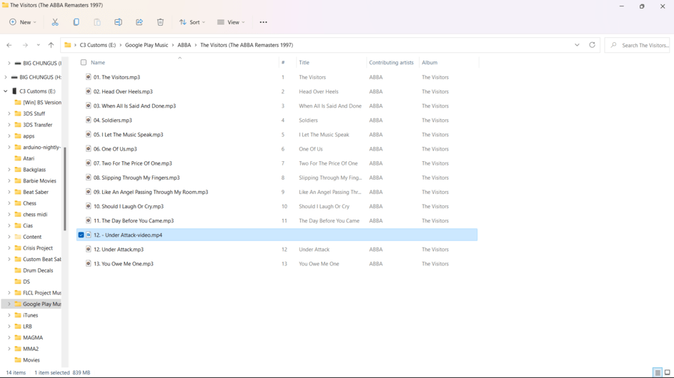

So I was able to get global config to work, but I didn’t like how it looked, so I undid that and moved the file to the album’s folder (hoping to get the camera icon) but now I’m stuck with this and it’s less than aesthetically pleasing.

I think that to make the TV icon appear, the name of the video file needs to be the EXACT SAME as the name of the audio file (followed by the video type).
In the screenshot you posted, the video file is named “12. - Under Attack-video” and the audio file is named “12. Under Attack”. There’s an extra hyphen at the beginning, so I guess that’s why there’s no TV icon next to its name in Plex.

That was it. Mostly excited about this feature so I can make a bit of a curated MTV :stuck_out_tongue:
