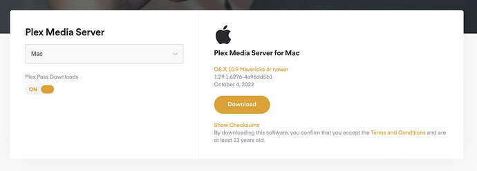

I reinstalled after I followed the uninstall instructions. I downloaded from your website.
That same small window pops up fast and disappears and the Plex server doesn’t run.
The small window appears to be to deny or allow this downloaded software to run.

What is the name of the PMS zip file you downloaded exactly?

Follow the uninstall procedure again,
then empty the trash,
and use the new transcoder preview this time please.
When you locate the link in the forum post, 2 fingered tap on it and choose Save As or choose Download Linked File so that you get the zip by asking for it rather than clicking a link.
