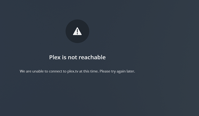

- Opening Plex and I get this message:
○ “Plex is not reachable. We are unable to connect to plex.tv at this time. Please try again later.”
- Tried to open Plex in InPrivate/incognito mode. I get the same result.

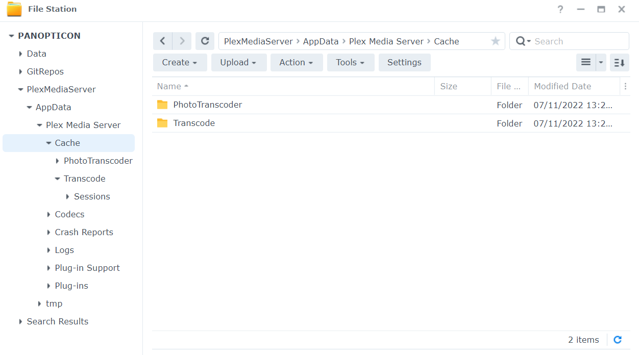

Hi Chuck,
I wasn’t able to find the cert file in that directory or sub directories.
Since I deleted the preferences.xml, should I uninstall again and reinstall PMS?
Thanks!

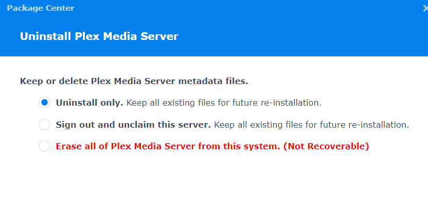

Does it matter which uninstall option I choose?
No…
Uninstall only removes the code.
Deleting the shared folder will get rid of all the files in there a lot faster than using the “Erase All” option.

Ok… now we get :muscle: with it
  1. Uninstall the package with KEEP option
  2. Install the package again
    – Plex Claim Token option
    – Click “Get Plex Claim Token”
    – COPY the token from the new browser tab
    – Return to the installer tab and PASTE the token in the box.
    – NEXT NEXT NEXT and let it install.
  3. Observe it takes a little longer to install (It’s getting new credentials from Plex.tv)
  4. When complete, confirm
    – Successful install
    – Successful claim – AND SHOWS YOUR PLEX ACCOUNT NAME (important)
Hi Chuck,
Tried these steps:
- Switched back to Google DNS (8.8.8.8)
- Choosing the middle option for uninstall
○ Sign out and unclaim
- Claim showed my username

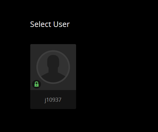

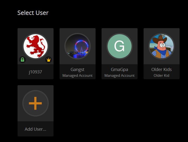

One weird thing I’d like to point out is that when I open up the Plex browser on my NAS it shows a different set of accounts than what shows when I click “Open Plex” from the plex.tv website.
Screenshot 2022-07-11 160030
Logs3.zip (179.7 KB)

- Went to this URL after reboot: http://192.168.1.169:32400/web/index.html#!/
- Plex not reachable message appears
I was using the Quick Connect URL, but going to the ip directly after the initial claim still gave me the plex not reachable message.
I wasn’t able to find any cert files like you mentioned in the Plex Media Server/Cache folder and sub folders after this latest install.
New log zip attached. Thanks again!
