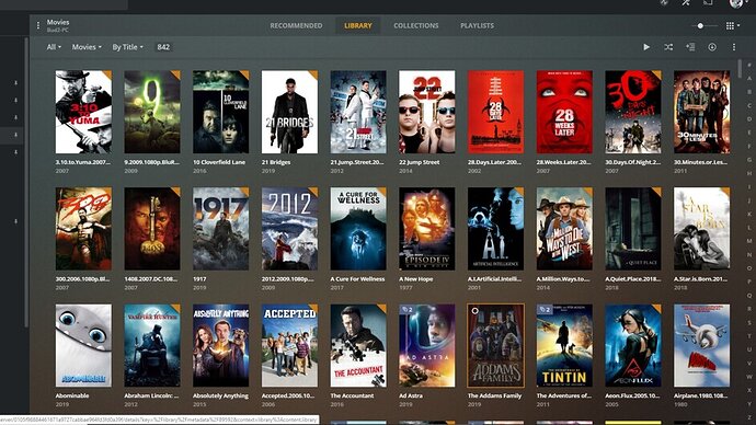

Naming issue: Most movie titles in my library just reverted back to the filename instead of the title?
Server Version#: 1.18.9.2571 and just updated to 1.19.3.2764 problem persists
So i just noticed this morning that in the last day or two most movie titles in my library just for some reason automatically reverted back to the filename instead of just the title? the only thing i can see is that most but not all are x.265 files? does anyone know why? I have tried updating and refreshing meta data, scanned library and nothing has helped. all titles were correct a few days ago and havent made any changes. The files are named properly and were showing up correctly up until the past few days
Looks to be that LMA is enabled and you have embedded metadata in your MP4 files.

So just before your reply I closed the pms and used a backup library database file from a backup a few days ago and restarted the pms. i did this because as i said everything was fine 2 days ago. but anyway this did work and everything seems to be named correctly now
 But your diagnosis seems correct as that they did seem to be all mp4 files and I did drop down LMA in agents prior to but it didnt change anything until i did the restore. so hopefully this sticks because manually editing 500 files isnt really an option.

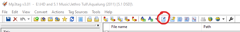

Since you appear to be on Windows, a tip: get mp3tag
Open it,
point it to your “movies” folder grafik
Then CTRL+A to select all files
then “Extended Tags”
You can remove any trace of embedded meta tags here, including embedded cover art.
After you have done that, you can ‘Optimize MP4’ in the right-click menu.
It is hidden under the “Utils” menu item, which itself only appears if you have exclusively selected mp4/m4v files.
