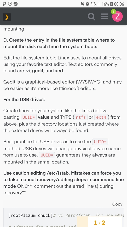

So my problem at the moment is I’m back to when I posted this topic; I’ve got as far as step D in Chris’ tutorial for adding the HDD at the Mounting USB Drives part of yours.
I can’t seem to edit /etc/fstab, it says I don’t have permission when I try with gedit, and I have no idea what I’m doing with vi. Any advice?
You have to do this as root, i.e. Linux admin: e.g. sudo gedit /etc/fstab in the GUI or sudo vim /etc/fstab from a ssh session.
That seems to have done the job! Thank you very much for your help and patience :smile:
