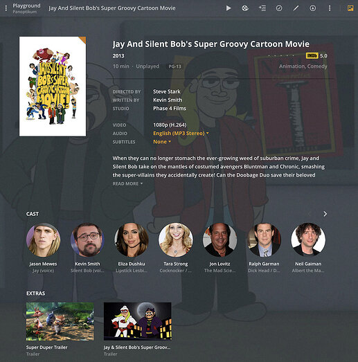

Ah, thanks Tom, I see it now.
Let’s try the following to narrow this down:
  1. pick a small video file and copy it
  2. rename the copy to “Super Duper Trailer-trailer.ext” (where .ext is the original file extension)
  3. place the file next to one of your regular movies – e.g.
Movies  <- library folder
  Your Movie (Year)  <- movie folder
    Your Movie (Year).ext  <- movie file
    Super Duper Trailer-trailer.ext  <- the "fake" trailer
  1. re-scan the library
  2. open the movie and check if the fake trailer is showing up
  3. attempt to play it
Does that “fake trailer” play ok?
to clean up afterwards… simply delete the fake trailer and re-scan your library again.
Is that what you meant?

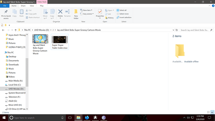

It does show up after re-scaning library.
My question is why did it stop working it worked just fine and I didn’t have to do any of this. But in answer to your question it does play. But I don’t want to download trailers to be able to use that feature. I never did before.
Thanks for checking…
Yes, that’s what I meant. I just figured that Plex didn’t even require a re-scan when I tested this myself… by opening the pre-play screen, Plex just found/added the trailer… and both (online, local) are playing fine.
