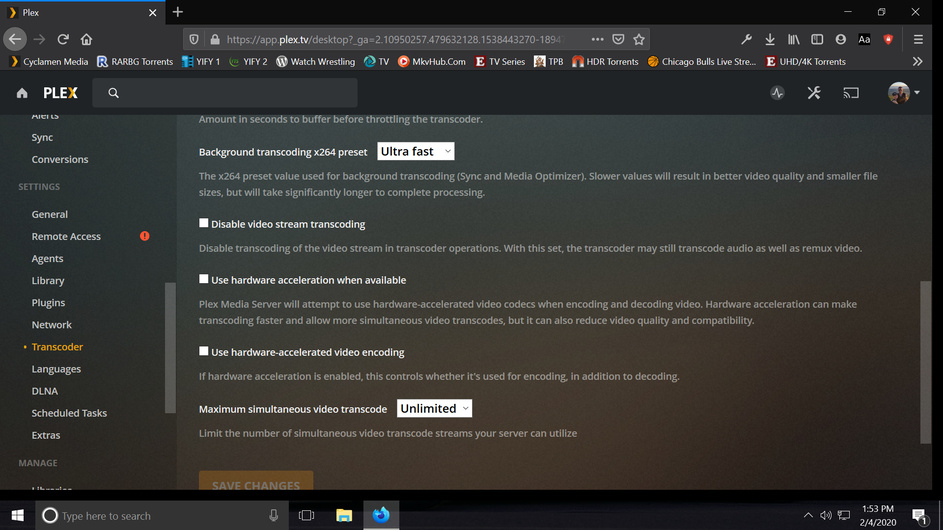

Do you have hardware accelerated transcoding enabled in your Transcoder settings?
Settings → Transcoder → Use hardware acceleration when available
If so, try disabling it to see if that’s what’s causing the issue. If so, you can then troubleshoot that side of things (try different video drivers, for example).
There were some pretty significant problems a while back on with PMS on Windows when hardware accelerated transcoding was in use. Here’s some background information:

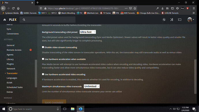

Thank you for the response first of all. The Hardware Acceleration is disabled as pictured. I updated my Video drivers, I installed beta version 1.18.6.2368 of PMS and still not working. Since the update though now my remote access will not work. It connects then disconnects.
