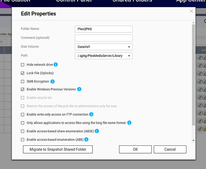

Here’s the, manually created, workaround until they get it fixed
Please read the instructions in full before implementing.
  1. Create a shared folder (I used PlexQPKG).
  2. Same Volume as PMS (DataVol) – Might be an issue for QuTS/ZFS users
  3. Manually Specify Path
  4. Using the drop-down navigator -
    – Scroll down to: .qpkg
    – Go into PlexMediaServer
    – Highlight & select Library
  5. Complete normal creation of this temporary shared folder
Here you see backups (compression) is running normally again.
When the next QuTS/QTS firmware release fixes this, You may delete this shared folder and return to using PlexData
WARNING: With this manual shared folder creation, the QTS ā€œMigrateā€ functionality won’t automatically update this manual path. You must manually change the DataVol .
Unfortunately with QTS Hero it does not let me specify the path
