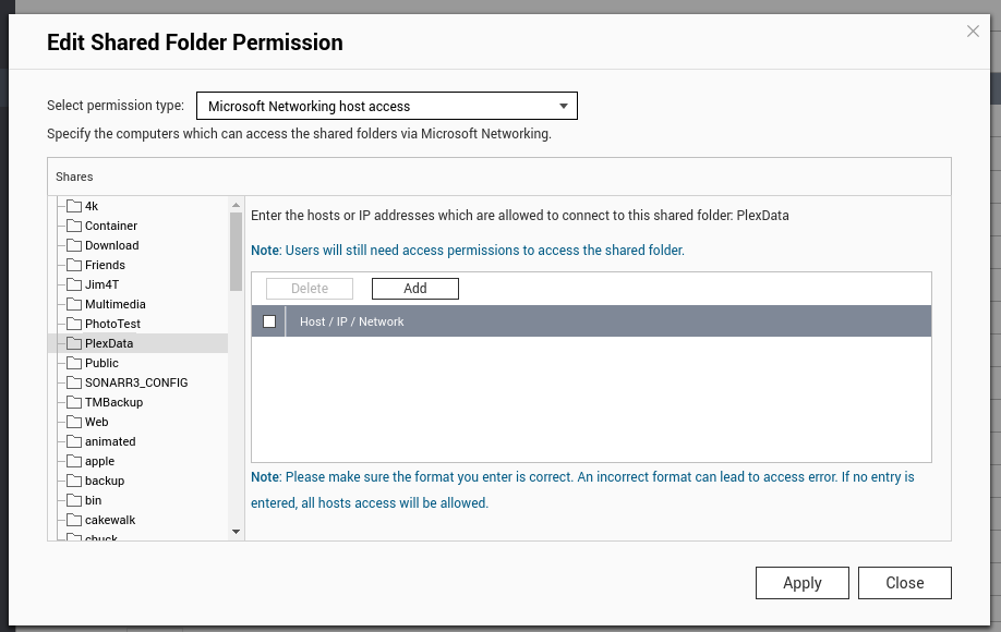

Go to Shared Folders and set the permissions.
I set the share as readable and writable by username admin.
You will have to enable sharing of the folder as you do for any shared folder.
In the screenshot below, you will see where I’ve compromised my shared folder permissions. Ignore the first one.
Please do notice, the default permissions are to deny anyone not listed.
On my screen, I can’t change the permission for the shared folder.
Do I have to do it from stopped plex server ?.
You can do it another way too:
  1. Stop Plex
  2. Delete the PlexData share
  3. Now create the PlexData share the way you want it created.
  4. Start Plex.
I don’t understand why QTS is not allowing you to change the permissions but I can.
My default is to make it so only user admin has access because of the personal information (Email address) and Plex Token in the share.
When PMS starts, all I care is that the share exists. I will use it wherever I find it.

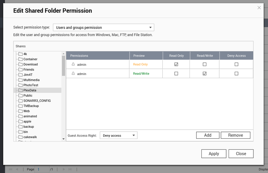

Unfortunately I continue to have problems accessing the PlexData folder, it just doesn’t make me change anything. i also tried to stop plex media server. I don’t understand why the folder isn’t in Vol1
what are you trying to do with it?
When I create the shared folder (which really doesn’t hold any data), I create it on the same volume as PMS is installed on. I do this because QNAP can install on a wide variety of volume naming rules (not everyone is DataVol1 / CACHEDEV1_DATA). I allow QNAP to tell me what it has done. I use that information to create the share.
As I stated above, if the PlexData share already exists (you delete what I’ve created and then create as you wish), I will use it.
Thanks, everything works now. (stopped plex, deleted the folder PlexData, created a folder PlexData started plex and inside it automatically came out the folder plex media server. top!
I’m not sure if this is expected behaviour, but after the first start when Plex creates the PlexData share, on subsequent restarts I get an error: ‘ERROR: Could not create PlexData share. Further assistance is available in our Support Forums. Continuing without.’
If I delete the PlexData share and restart Plex the error doesn’t appear, so Plex doesn’t appear to check if the PlexData share exists before trying to create it. What’s wrong? Is anything wrong? What can I do to prevent this error from being logged?
I had the same problem, and the same solution. I wonder if it’s because the PlexData share apparently doesn’t have a “Volume” at all. (see your screenshot, Volume column)

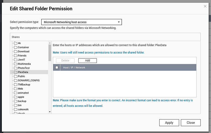

It appears that sometimes when you (a script on Plex stsrtup?) make the share, you do not successfully create it with the correct volume (see screen shot above, which also reflects what happened to me). I’m not sure how or why, or what actually happens, but see screen shot for some anecdotal evidence.
For me, the share was listed as above but could not be edited, or browsed. I only sorted this by deleting the share, and recreating.
James,
I don’t see how that’s possible but do see what you have there.
I do set the share so only user admin has access. If QTS isn’t allowing you to edit it for looser permissions, that is on QTS. You have personal info in Plex. I am taking the position of ensuring I don’t expose any data you don’t want exposed to others.
I expressly keep security tight because I do not know if other users are using the NAS and the QTS interface (qcli_storage) is very awkward to use and would require the scripts have your admin password (which would require a pop-up window) to operate like the web gui.

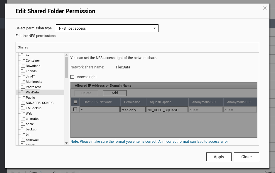

Interesting - this might be because i do not use the “admin” user, I have another user name with admin permissions (admin group). I invariably log in with the other user (and admin account is often, but not always disabled*), so I probably couldn’t see the share “properly” with the “other” user.
James
*sometimes I have to use the admin account for certain things so I re-enable it, do something, and then disable it again.
James,
Being in the ‘admin’ group doesn’t carry enough privilege in how I’ve configured it and how QTS allows me to specify permissions.
QTS doesn’t really implement GID (or even UID for that matter) in everything internally.
Specifically, I must state which user(s) have read and which have read/write.
The only way I could setup the share permission as you do in the UI is to have a “session token” . To obtain one would require an interactive password session (popup) each time – which isn’t practical.
