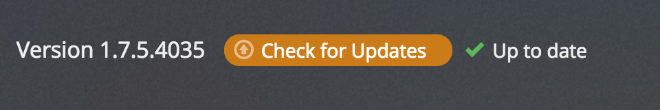

What PMS version is your server?
Version 1.7.5.4035

@ryanfay upgrade to the latest version and see if the issue has been fixed in the current release.
Outside of updating to 1.8.0 to see if that fixes your problem I don’t have much else to suggest. You are on a supported server release it appears, you have the drivers installed since it is working with the other Media systems. Can’t really think of much else.

Mine is showing already up to date.
Turn on Plex Pass channel in server settings. Can also manually download from Plex.tv/downloads turn on Plex Pass from website as well. Current Plex Pass version is 1.8.0.
