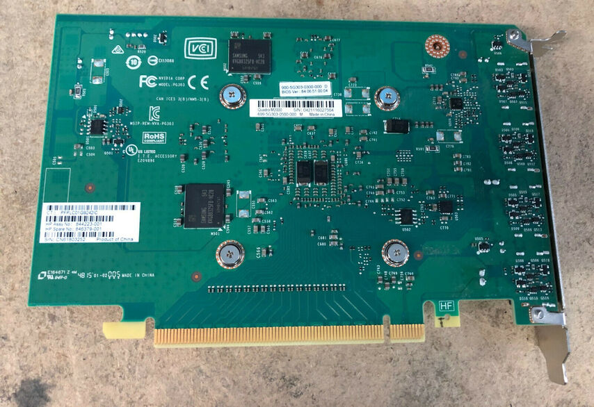

Hey TechnoJunky, Thanks for sharing that. You possibly saved me from making a mistake. Do you know where the generation numbers are on these cards? I’m taking a look at this one on ebay and can’t for the life of me find those numbers on it…
sorry, no idea.

Hey, that model that you show in the picture is the GM206GL (GM206)
As the model of the pcb is the PG303
https://videocardz.net/nvidia-quadro-m2000
