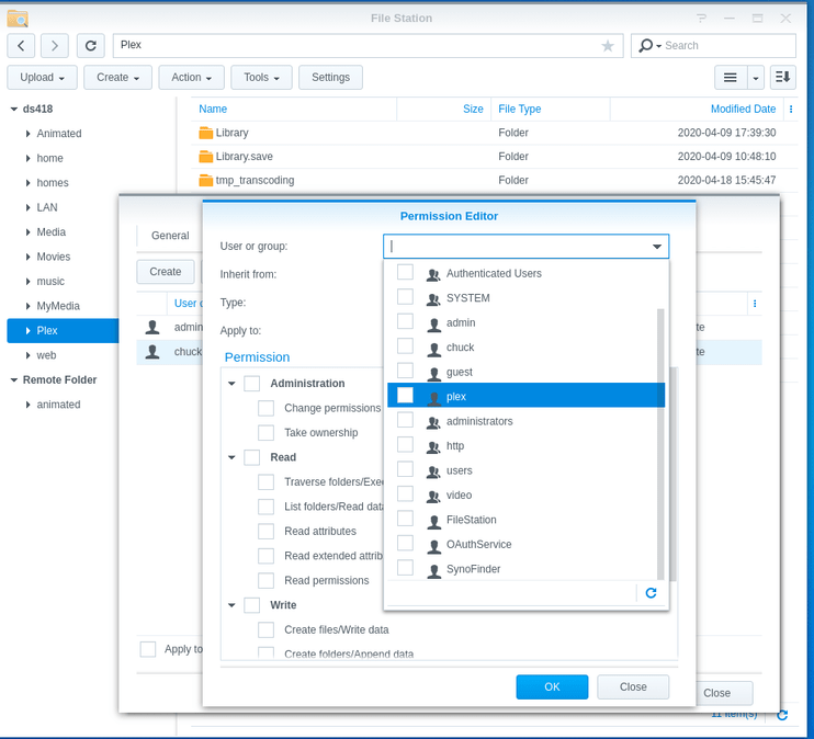

Stop Plex
  1. Open File Station
  2. Left Panel - Right-Click Plex
  3. Properties
  4. Permissions
You’ll see the permissions for the Plex share as seen
  1. You’ll see user plex listed.
  2. On some systems, I’ve seen plex listed twice.
  3. We’re going to fix that now and reset the permissions for the entire Plex share
Here we go.
  1. Delete user(s) plex from the Permissions window.
  2. Don’t delete any other usernames listed
  3. Now click “Create”
  4. Popup appears
  5. In the Username box (at the top) is a selector.. Click it.
  6. Scroll down the drop box and find Plex.. check the box
  7. click in somewhere else and the box will close - showing user ‘plex’
  8. Now to assign permissions (everything)
  9. OK that
  10. When that closes, we are back at the main Permissions tab
  11. Lower left - Apply to this folder, sub-folders, and files. – CHECK that box.
  12. Click OK
  13. Let it do its thing.
  14. When done, Start Plex
