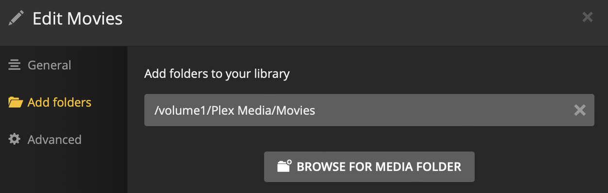

    Path like mine - /volume 1/Some Folder/Movies - write out or screenshot yours.

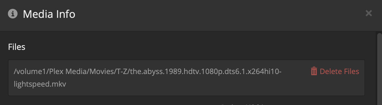

  2. Where is Red Notice looking for the movie file?
    Click the 3 dots next to the pencil icon and then “Get Info” … it will have the path:
Those two storage locations need to match up and be available in order for the movies to be found.
You might also want to grab the screenshot for your Movies library settings like you see mine in the previous post - that will tell us where your library is looking for movies.

So… you have Red Notice as an example earlier of “not available” but you used Terminator for the movie path… so now we have to ask, is Terminator also showing “not available” in your Plex?
Try not to hurry through this, it’ll help avoid repeating things. :slightly_smiling_face:
The paths actually do match between library and the Terminator example so they should be fine as long as that folder is available.

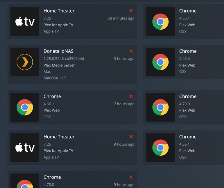

Also, go to your account page on Plex and screenshot connected devices… it’s possible you have two servers setup. That could also explain some things.

when you want a screen shot of the"connected" devices - is this what you mean?
ALSO i have no problem and I am on vacation so I have time, to delete and start over AS LONG AS I dont lose the videos on the NAS drive, If you can recommend the best HOW to video - with a Synology 920+ OObe modem connected to an EERO pro.
So only one server in devices… that’s good.
