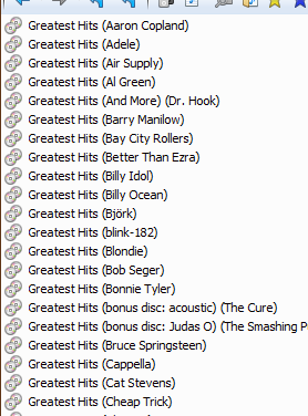

You were also already asking that Plex respect the Compilation tag and did not use the string ‘Various Artist’ in that way as it did not allow for other languages. All of which would require code changes within Plex. So no different from my request. Just that what I have suggested is first of all relatively simple for them to do and it would deal with everyone’s different requirements for this aspect of music Library organisation. So small pain for HUGE gain.
Or I can just put all my singles under one made up album that would get grouped and listed under Various Artists. Not ideal as I then lose any reference to the album/EP/single that track may have come from. But just a minor irritation and then it all works ok with Plex’s current code and that’s certainly easier than expecting them to change it.

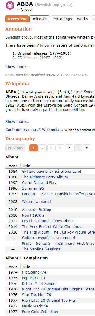

tracks from compilations SHOULD be listed under the artist in a designated ‘compilations’ section that lists and links all tracks (by that particular artist) to the applicable compilation album.
under artist:
  • popular tracks
  • albums
  • singles (tracks with no album)
  • compilations (only tracks by this artist, sorted and linked by compilation album)
plex artists should look very similar (if not exactly the same) as the artist page at musicbrainz (they are using MBz data after all).
