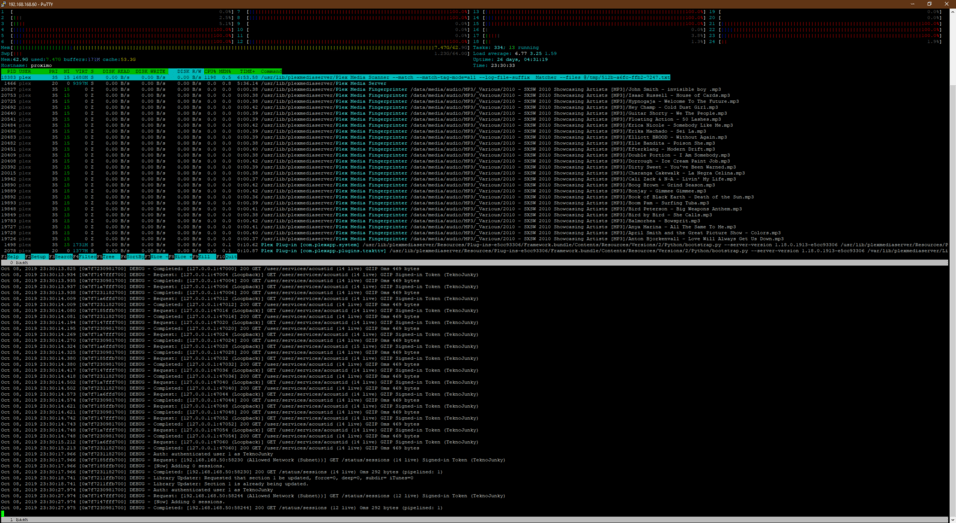

I also have the new music scanner get hung up on certain folders/files.
12 out of 24 cores are maxed out 100% cpu.
some example screenshots
I have not yet had time to separate out and identify the specific files, but I have narrowed it down several folders each with a bunch of (not random) mixed files, some exceeding 1000 tracks.

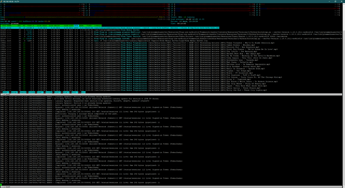

these 2 pictures are only a couple minutes apart
fingerprinting before hang
fingerprinting after hang
logs shortly after hang manifested

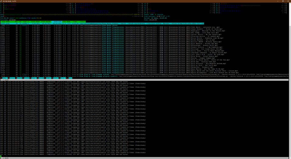

I will let this run all night, and post another screenshot with what I assume will be exactly the same as above.
screenshot after ~8 hours of letting plex process, appears to be the same threads going.

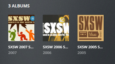

right now I have scanning 2 folders
  • 2005 sxsw containing 768 files
  • 2006 sxsw containing 934 files
these appear to have completed processing, according to the ‘alerts’ log.
4:09PM Finished processing SXSW 2005 Showcasing Artists
4:09PM Loading metadata for SXSW 2005 Showcasing Artists
4:09PM Finished processing SXSW 2006 Showcasing Artists
4:09PM Loading metadata for SXSW 2006 Showcasing Artists
4:08PM Finished processing SXSW 2005 Showcasing Artists
4:08PM Downloading metadata for SXSW 2005 Showcasing Artists
4:08PM Downloading metadata for SXSW 2006 Showcasing Artists
4:08PM Finished processing Various
4:08PM Loading metadata for Various
4:08PM Loading metadata for SXSW 2005 Showcasing Artists
From the screenshots earlier, it looks like the 2010 SXSW year is what it was stuck on.
yup 2011 and 2012 caused problems as well, I started at the earliest folders and working my way up.
  • 2007 sxsw containing 724 files appears to have been successfully scanned.
  • 2008 sxsw containing 761 files appears to have been successfully scanned.

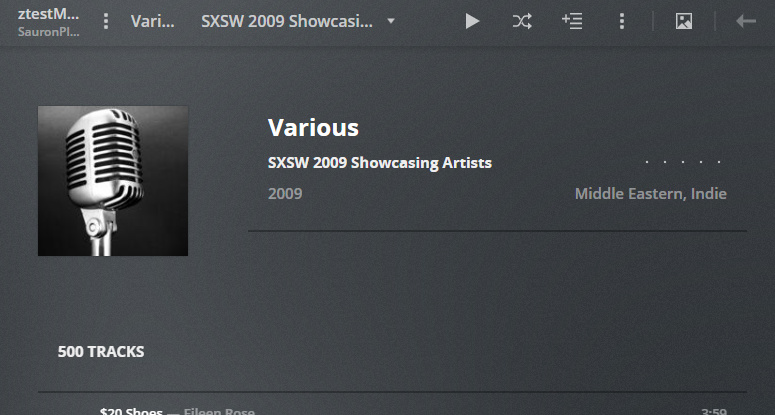

plex being hung after adding the 1250 files, I stopped then I reduced the 2009 sxsw folder from 1250 files, to 500.
After restarting plex and rescanning the test music folder, it appeared I was able to complete the rescan, including the 500 files that were left in the 2009 sxsw folder.
plex is still re-matching/re-pulling metadata from the other sxsw folders as I post this, but the 500 files were actually added to the music library (which was not the case during the hung threads).
