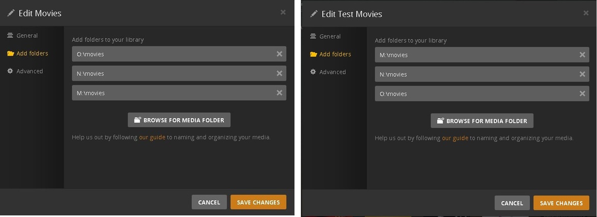

I have one library each (except the new test movie)
The two movie libraries point to the same media folders
The folder structure for a movie is;
One movie per sub-folder
the test scan missed 16 movies, I’ll see what I can find out on this.

Found;
Could be the 16 missing movies..
EDIT;
That is what it was, split them apart and now the counts match.

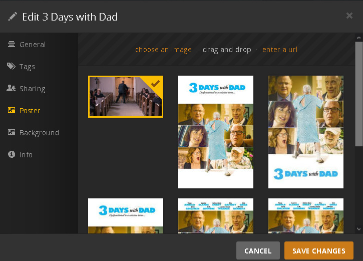

First thing that I have noticed is a lot of the movies don’t show the poster but a frame of the film… Even though every one of them that I checked has at least one poster available under edit. That’s also a problem because most of the ones i checked had 3 4 5 of the same poster showing, That’s a lot of poster storage…
Because of the number of movies, I’m guessing I would have to edit one in 10, that’s a lot of fixing… I know under normal conditions it would just be the one’s that have been added. Also all my posters are local with the movie, including an NFO file created with TMM… So I would have thought that it would have just used that one.
That is interesting and not something we’ve seen internally yet. Do most of your movies have local posters in the folder with them, like in your example? If so we will use those ones by default.
If it doesn’t it may that something failed trying to download the remove poster - would you be able to share your logs with me and the titles of some of the movies which are missing posters?
Also, does hitting “Refresh Metadata” on a movie which is missing a poster fix it?

The above folder example, 3 Days with Dad (2019)
the poster that I have with the movie is

Ah interesting. That is definitely a local poster - can you check how those local images are named in that movie’s folder?
