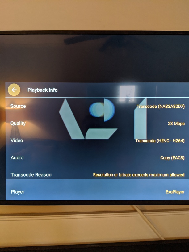

While fooling around with some settings, I came across the “optimize” feature within Plex and selected the movie in question to be optimized for TV. Today when I walked through the test FordGuy61 suggest, I came across the following results. It would appear that you are all correct in that both the FireStick (4k) and Chrome browser are trying to transcode the video when I try to play the original copy. When I play the copy that was optimized, it runs as “direct stream” with no buffering..I can actually fast forward as well! If this all works, I would believe that I could go back to hosting Plex from my QNAP as we only have a single device streaming at once.

Screenshots as per request. Please note that “NAS3A82D7” is the original QNAP mentioned earlier and “PlexServer” is the VMGuest. Both have the same Network connection and are pointing to the same storage device (qnap).The optimized version is part of the database on the “PlexServer” VMGuest.
PS. I apologize for the low quality of the screenshots as they were taken from my tablet.
Thanks for the updated information.
You may be running into a problem with the AndroidTV app.
There are many reports on the forum with people having trouble with the FireStick 4K (some linked below). It transcodes when it should direct play.
Per this thread, it seems v7.30 fixes the problem. However, it is still beta and not yet available via Amazon (currently v7.28.0).
It seems you have two options: 1) Wait for the fixed version to become available via Amazon; or 2) sideload the beta version and see if it works. Note that the Amazon store version always lags the Google Play version, sometimes by several weeks. This is due to Amazon release processes. Do not sideload the Google version on your FireTV. It won’t hurt anything, but it is built differently and will probably be unstable.
