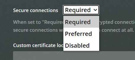

That does not help if your clients are still using the router as its DNS. Clients will still be subjected to the DNS Rebind Protection in the router. Manually set the DNS settings in the clients and test again. Also if you disable Secure Connections under Settings | Network of PMS in the web app, this will further validate the root cause is DNS Rebind Protection.
I did try changing it to DISABLED - no difference.

Well HOLY CRAP!!! I FINALLY got it working!!! Here’s the trick - yes, you have to use Port Forwarding, BUT once you set your Port in REMOTE ACCESS, you have to DISABLE the REMOTE ACCESS. Then set the Port Forwarding on your router (you can use the same default, 32400), and you have to DISABLE Secure Connection. I did NOT have the DNS Rebind issue. It also connected on the Auto Tri-Band, I did not have to separate the bands.
