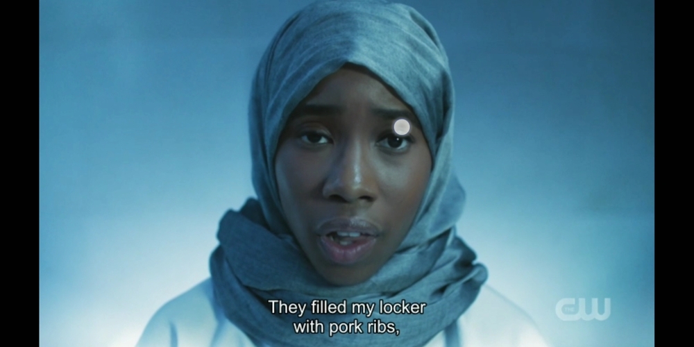

I’m putting some image examples here but it’s definitely clearer in the videos I made.
When I notice that the transcode went haywire:
I switch to Original quality, then back to 720p 2Mbps and it looks fine again (we can see that there’s more pixels in the first one):
Another one gone haywire:
I switch to Original quality, then back to 720p 2Mbps:

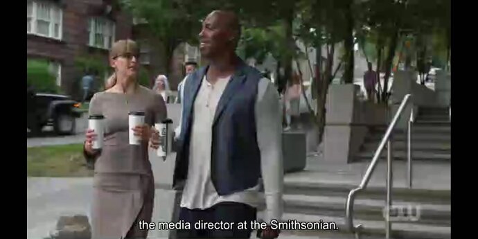

I tested this episode of supergirl in 240p 0.3 Mbps:
320p 0.7 Mbps:
480p 1.5 Mbps:

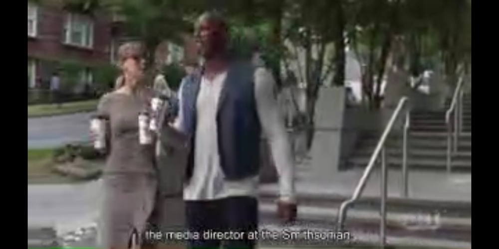

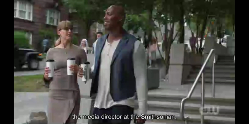

I know it’s surely not the real transcoded resolution as you pointed out earlier, but when you compare the resulted transcode of the first attempt of 720p 2 Mbps (took from the video at 0:08):
I would definitely place it better in quality than the result of the 240p 0.3 Mbps transcode but worse than the 320p 0.7 Mbps one.
