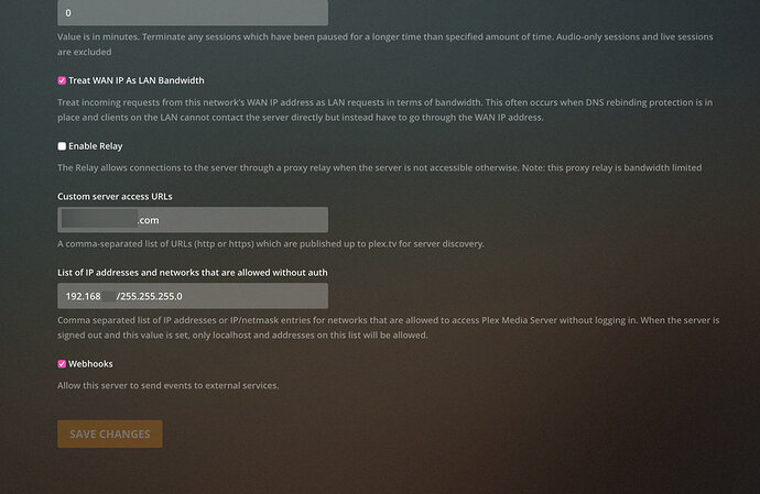

Custom server access URLS:
https://yourdomain.com:32400
Custom certificate domain:
turn Maximum Simultaneous Transcodes to unlimited, and Remote Streams allowed per user to unlimited.
“Terminate Sessions Paused for longer than” to 20.
untick Disable Weak TLS versions.
And Secure connections to Preferred. and try.

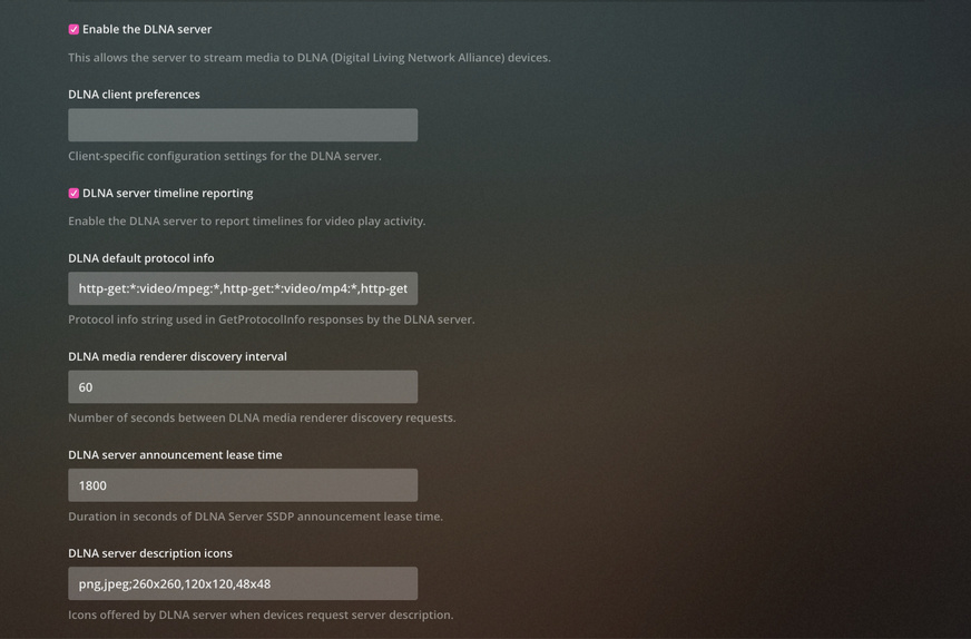

if you dont use DLNA just disable all of the tick boxes
EDIT:
https://yourdomain.com/
no port on top one and add /
Shouldnt it be the other way around?
EDIT:
i have them like i edited.
but i dont open my port 1:1.
if they dont work try another port other than 32400, and you have port 443 opened in firewall to server yes?
I did all of that & restarted (reboot) server. Nothing changed.
