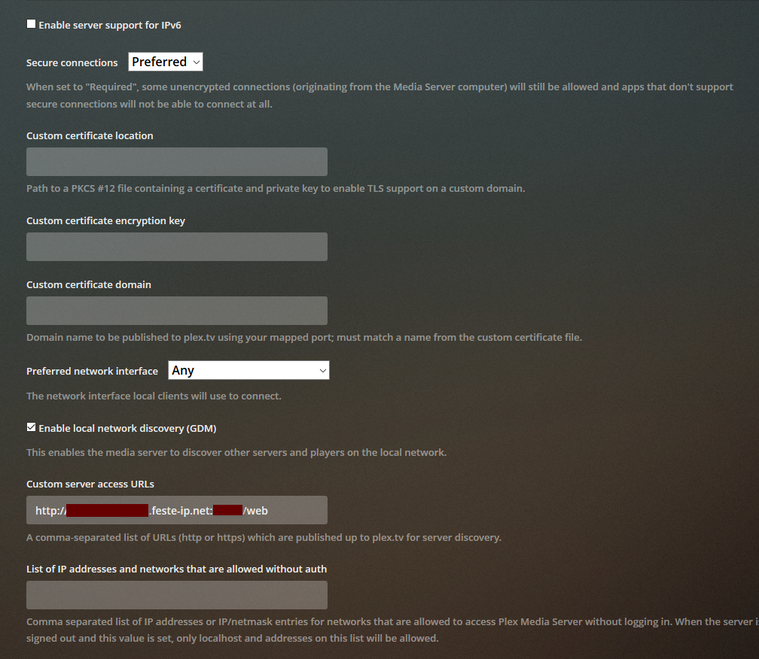

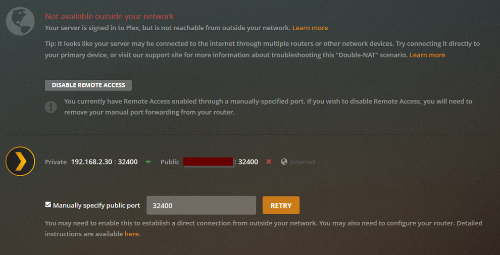

In the settings for PMS I have only set the custom Server Access URL and provided the portmapper data there as I read in other forums. Then I tried to enable remote Access, which is green for a few seconds and then it switches back to " Not available outside your network".

Here are two screenshots of my PMS settings:
I forgot to mention, the computer running PMS is connected directly with the one and only router.
There are no other router, access points or anything involved so I do not really understand the message that there shall be a double-NAT problem
Please clarify what a “DS-Lite” is? Nintendo DS Lite device ?
If you have a chain, Computer -> something -> router -> Internet, and the addresses blocks change at each hop, PMS will detect as a possible double NAT and so flag it.
It compares 1st hop WAN IP with Public-facing IP. If not the same then it calls out “Double NAT”

The custom URL I put in the network settings is that said IPv4 alias I got from the portmapper service.

That is correct. The built-in connectivity test will always fail for “custom server URLs”.
You can only use things like canyouseeme.org to test (or go outside and test yourself over a foreign WiFi or mobile data)
