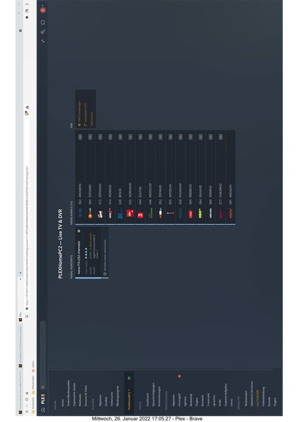

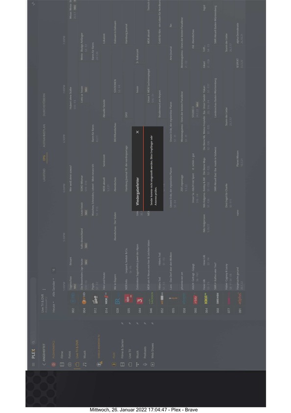

The normal German ARD programme already does not work, see screenshot.

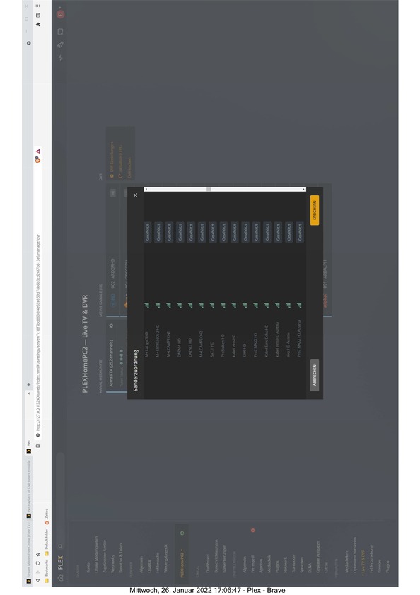

The 2nd screen shot shows that I have set up everything. The 3rd shows that ProSieben HD is blocked, even though it is enabled because of the HD+ card.

Hi guys , is there no one here who wants to help or can. I have now uploaded the requested screen shots.

Screenshots show that the channels that won’t tune are “Protected”. Plex does not play DRM content which you have already been informed of. It also appears you are not using a supported tuner.
