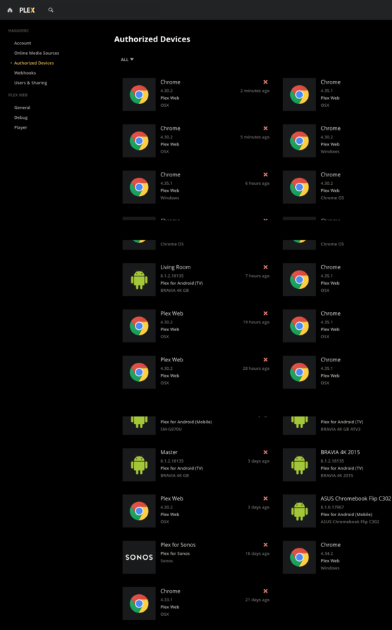

If I go to plex.tv, I can see my account, but not PMS.
  1. While at Plex.tv,
    a. Authorized devices (upper left)
    b. Servers tab
    c. REMOVE the old server temporarily (it will return)
    d. sign out your browser from your plex account (upper right)

I followed the steps. Removed the server. When I log back in on a new incognito window to the URL posted, I end up at the general Plex interface. I can’t see any PMS settings although the Plex app on my TV is working just fine.
I also opened Plex from the app center of my QNAP interface which also took me to the same URL as above and the same thing happened.
I don’t understand how my TV’s can see the the PMS and playback content from QNAP NAS but I can’t see the PMS myself?
Updated: Now my TV’s can’t see the PMS either.
There are no servers and no servers tab.
Now I am getting an “unclaimed server” error that will not go away.
