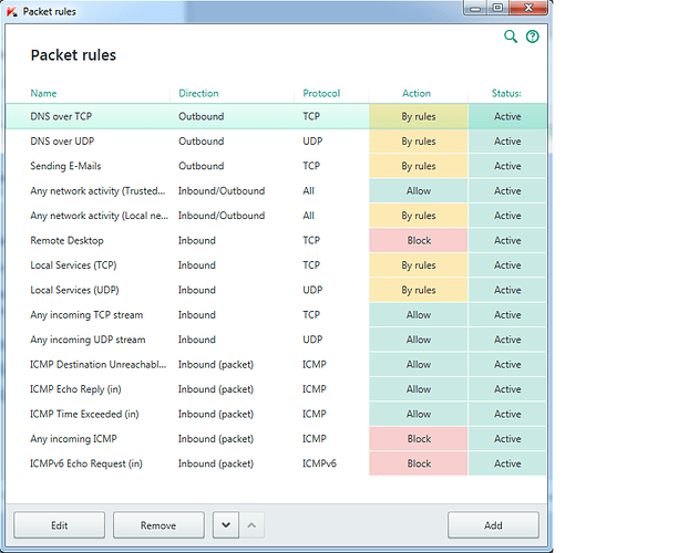

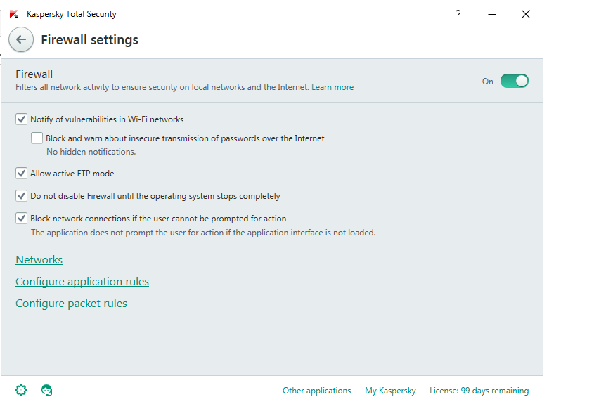

Here are some pictures of my settings in Kaspersky Total Security FireWall, When my computer rolled back or at least I think so from the infected Kernal32 files.

First lets try disabling your firewall and any other DPI/av service you are running, Tell can you tel us a little about your network configuration. not
