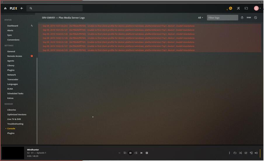

When you try to play a video, what shows up in the dashboard details?
What shows up in the console log?
Unable to
find client profile for device; platform=windows,
platformVersion=7sp1, device=, model=standalone
when selecting EAC3 audio track.

The messages on Console about client profiles can be safely ignored.
There’s a few threads about that.
